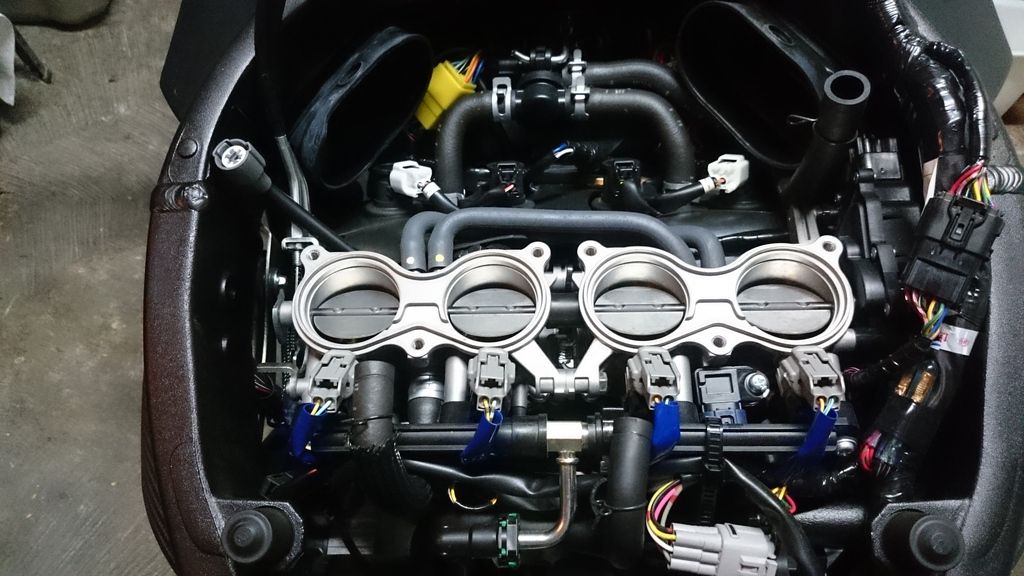

Went ahead and pulled the exhaust. Also getting ready to start removing the exhaust valve actuator and the pair valve
2016 GSX-R750 "BLACK BETTY"

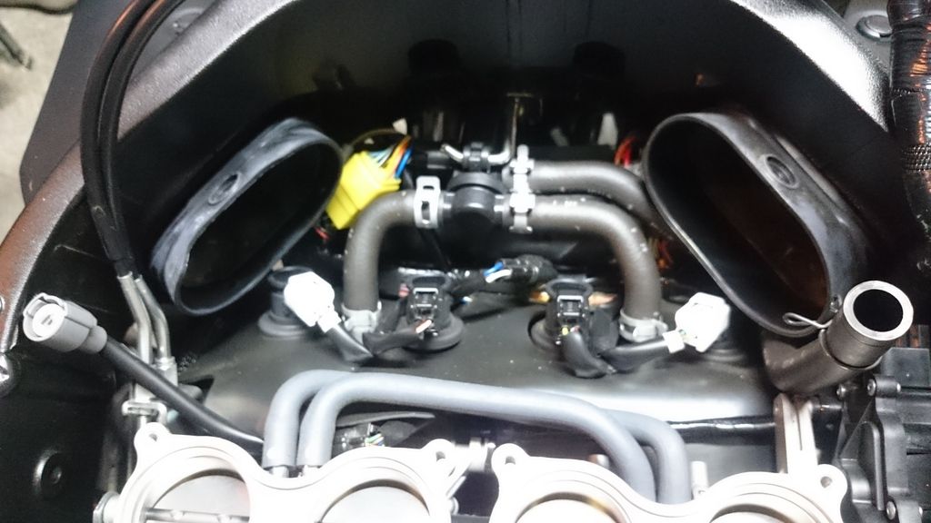

So for anyone who might be wondering what the later model PAIR valve setup looks like, here it is. It no longer has a small vacuum line connected to the throttle bodies, it is electronically controlled. So there are only 3 hoses connected. There also do not appear to be any reed valves anymore, its just 2 nipples sticking out of the top of the valve cover. So its very basic, if you want to remove it entirely, just pull it out and then install 3 rubber cap plugs where the hoses were, 2 on the top of the valve cover, and 1 on the underside of front right corner of the airbox. For now I am simply going to install 1 rubber plug at the airbox port and see how it works out.
Now after doing my research I noticed there is also a mod to connect the crankcase breather hose to the 2 ports at the top of the valve cover in order to create negative pressure in the crankcase. I would like someone who has more experience with this to chime in as to wether its a good idea or not. I would imagine that this could create an issue with oil consumption since it would so freely vent oil mist out of the exhaust.

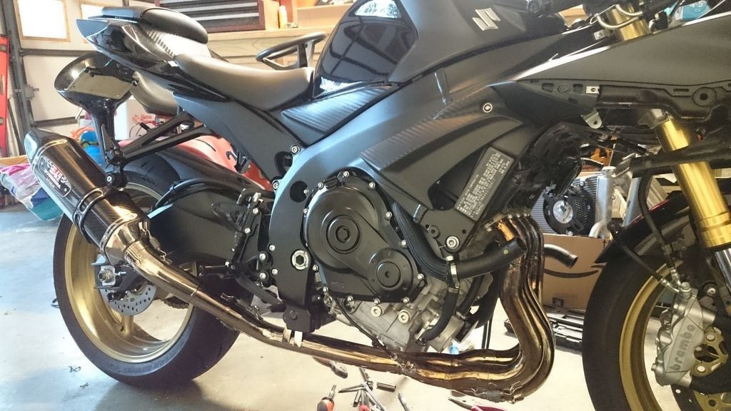

Oh hell yes. The exhaust showed up today. I will admit, I first made the mistake of not reading the installation instructions because it seemed pretty straight forward... I installed the yoshi system using the original header crush gaskets. WRONG. The bottom edge of the radiator hits the headers. I guess you are supposed to install the header with no gaskets for clearance. My bad, so I did it over again and installed system with no gaskets, still hits. WTF. So I just installed a 1/2 billet spacer on the lower radiator mount so it would clear the headers. Got it fired up and it sounds amazing. I am still yet to reinstall the fairings, but it should be done tomorrow. Hoping I don't have any fitment issues with the radiator being spaced out at the bottom..

Yeah the 750s need a longer bracket on a radiator so the Yoshi headers clear .

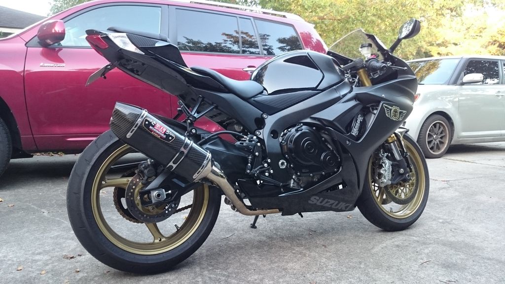

sorry for the delay. Here's the pics of it all done. I love it. The sound is great. It runs great with the dano's flash. I feel it could still benefit from a dyno tune, but theres really no need to rush into that. I dont get and popping at all. All around this was an excellent upgrade.

Glad you like it, I did pair valve removal or whatever. No backfiring or anything, Not sure if you did it yet. I removed it all, cleaned up the spark plug engine area a lot.

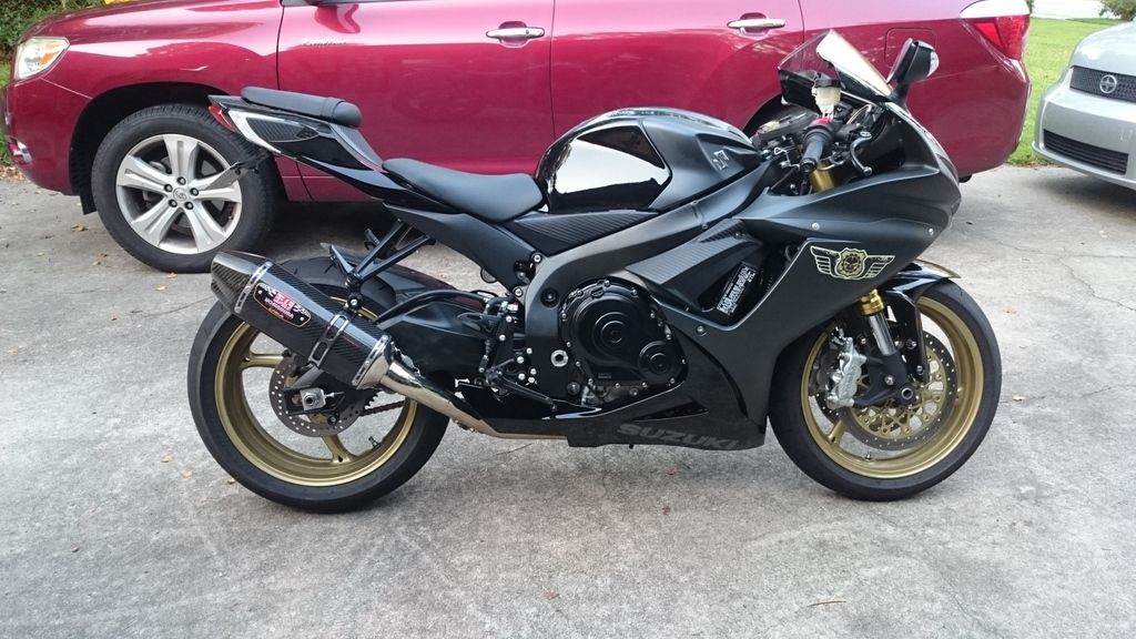

Snapped a nice pic of Black Betty before taking her out all day for a good ol' flogging. I have a new Zero Gravity double bubble smoked windscreen on the way, and also a motion pro R1 throttle tube.
