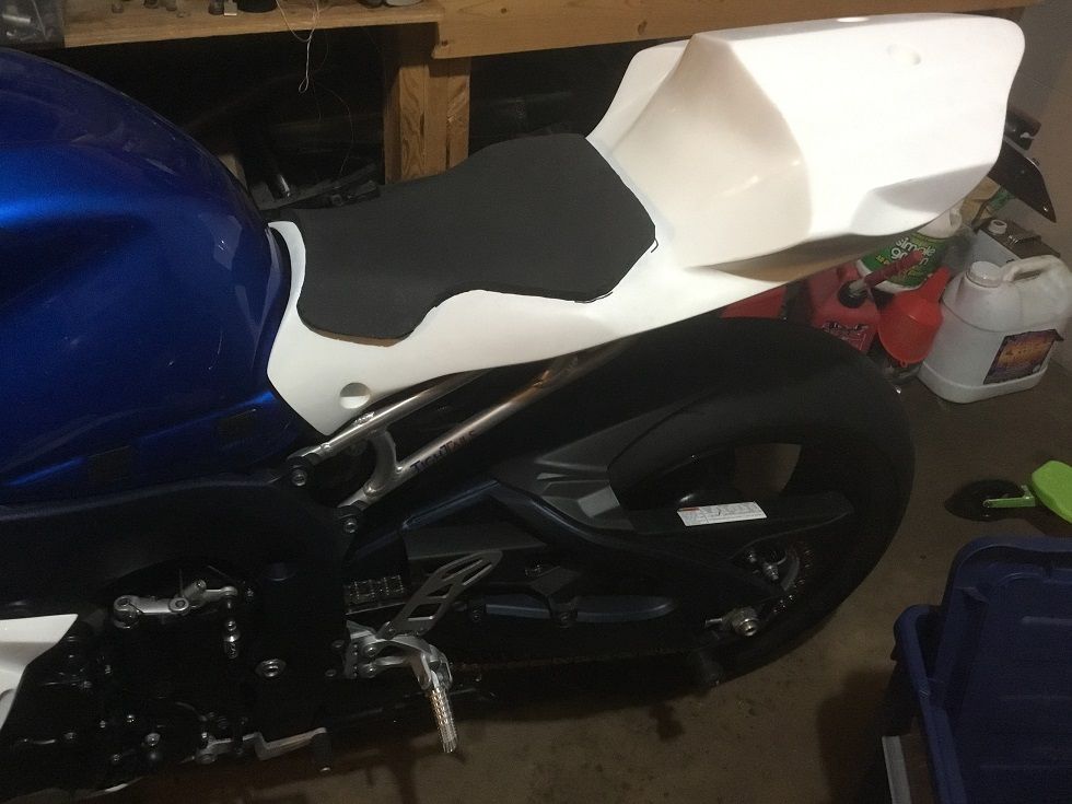

Put together the bodywork from the crushed box from Slovenia...
This is my second set of race bodywork I’ve installed myself, so I'm not all that experienced, but my impressions...
Fit was really crappy. I felt I was going to crack the one piece upper fiberglass trying to get that right side pulled back far enough to the frame mounting point. Worst part of the kit.
Gap between the upper and lower was a little excessive and poorly finished.
The lower bellypan while it fitted was too close to the headers and rear tire. And just looked OK.
The edges of the front fender and the upper fairing windscreen cutout were not cut well and looked asymmetrical.
The superbike tail fit was nice, though. Best part of the kit.
Need to get some simple lights installed to get some street time before trackdays start.

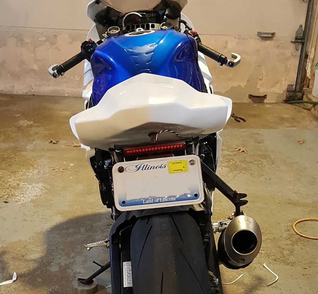

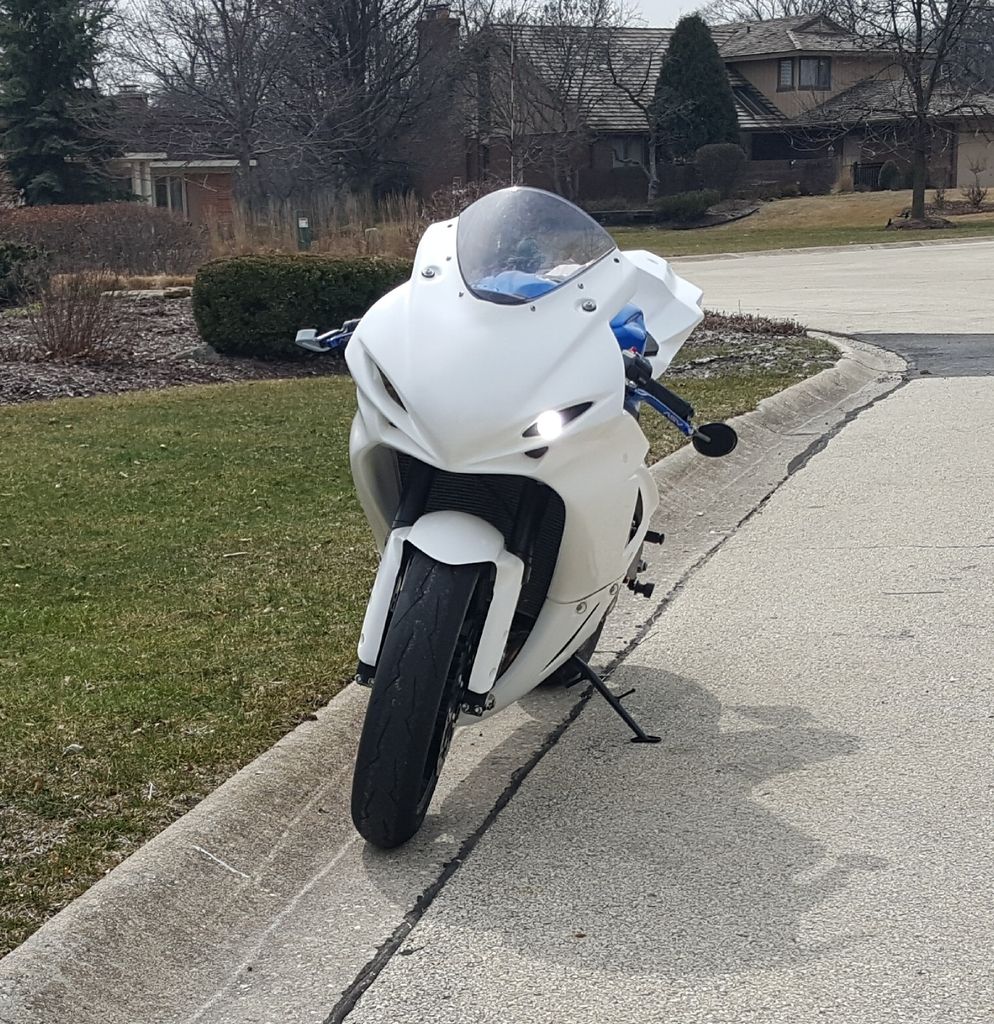

Finished up my license plate/taillight bracket...
Just need to figure how to mount some lights and I'll be sort of street legal.

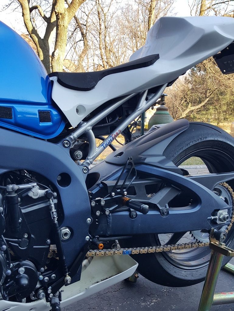

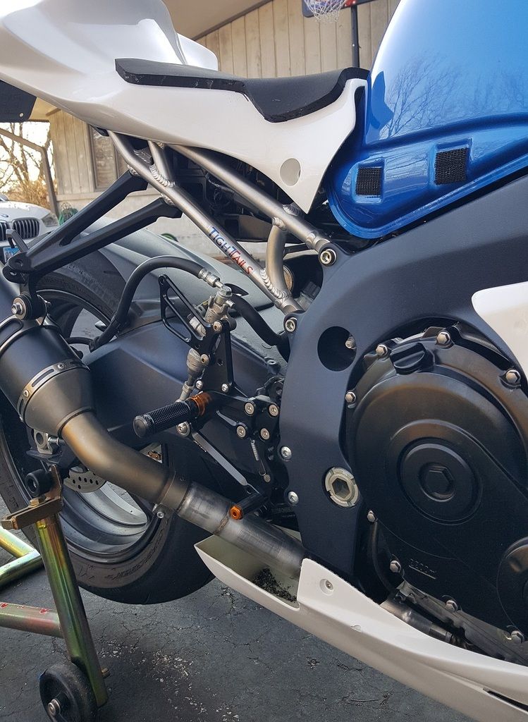

Last thing are the rearsets. Man, I’ve been dreading this. Just so expensive for something the stock ones do just fine. But, my legs are too damn short to really be in a good position on the tank for the track. I think it also hinders my ability to get my leg and knee pointed out as well on entry and mid corner. I’m looking to go extreme track, so I’ve put in an order for the Sato Racing race version rearsets.
Before someone asks, even though they aren't technically listed for the 2011-16 GSXR600/750, they can be made to adapt with just a little grinding and relieving of aluminum... I hope
JCW is offline
post #58 of 133 (permalink) Old 03-21-2018, 05:47 PM Thread Starter
JCW
Join Date: Sep 2017
Location: Chicago, IL
Posts: 330
All that was required was filing down a small ridge on the backside of the frame at the upper rearset mount to make it flat with the mounting surface. Probably 1-2mm wide, 1mm high.
The rearsets are set at the third from the highest setting.
The rear brake master cylinder is held by red locktight 4mm socket head bolts. If you don't use heat, I bet the chances of rounding the allen head is high. Enough heat, and the bolt just spins out with no effort.

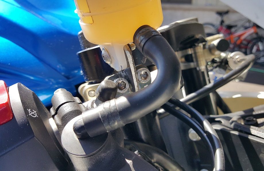

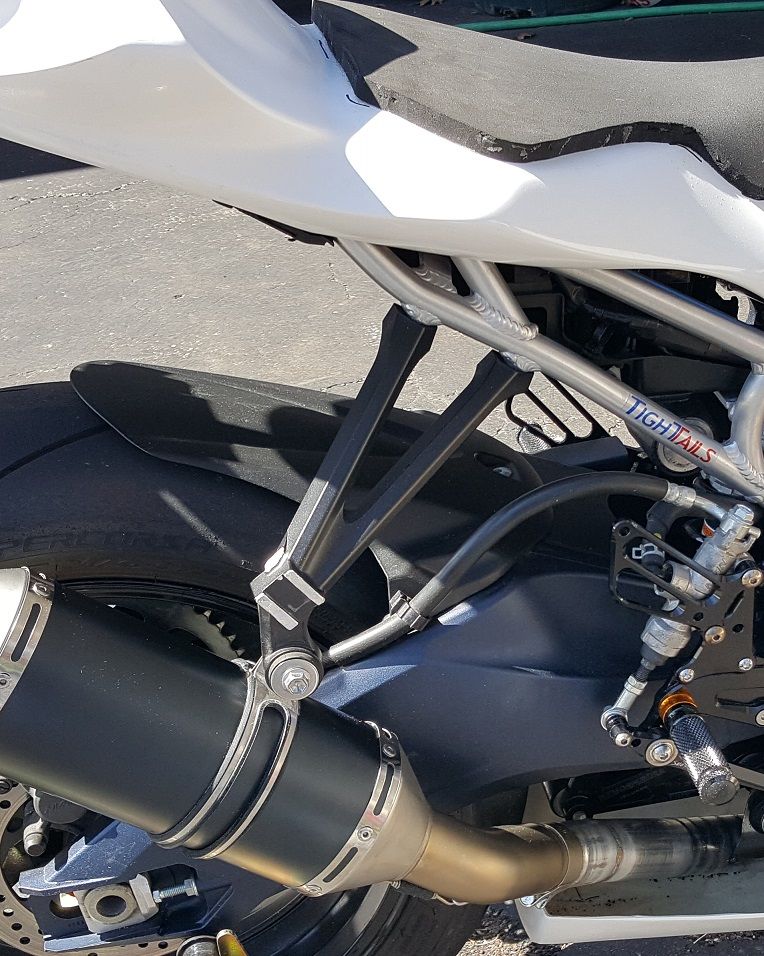

Took a cut off wheel/grinder to the passenger peg mounts and death hook.
fabbed up a little brake reservoir bracket.
JCW is offline
That tail looks nice man. I opted for stock seat just because I've had herniated discs in my lower back.

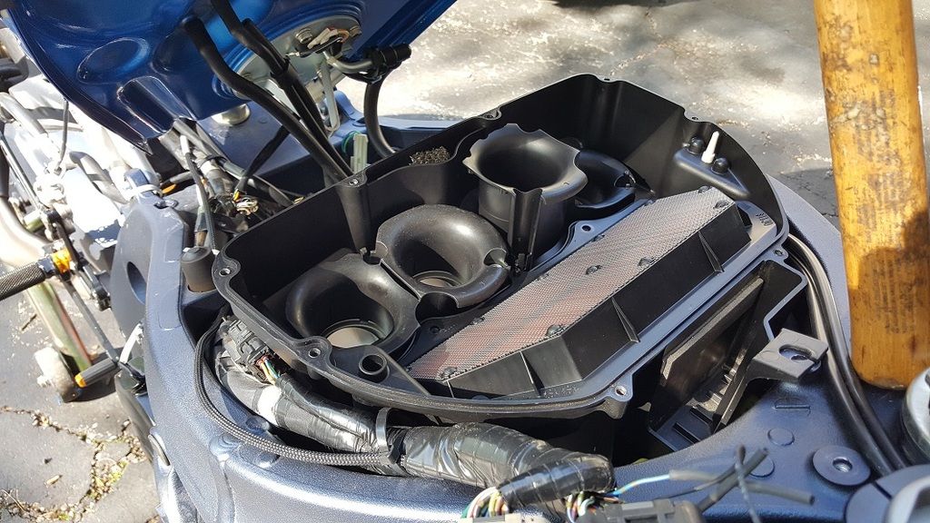

Anyone know why they used unequal velocity stacks for the 750 and equal for the 600?
Anyway, I'm thinking of throwing on a set the shorter stacks. There's a couple on ebay for $20.
Funny, Danos offers their shorter stacks for $150. LOL.
Usually when the stacks are staggered it's due to airflow testing, shape of box to engine flow CFM. Those engineers are pretty smart lol

I think I read it was just a compromise of low and high rpm driveability.
I'm going to install the short ones for the track. Just for sh!ts and giggles...
Mixed height stacks gives you power all across the RPM range. All short stacks typically move that power to the upper rpm range. Drag racers run all short stacks cause they are always WOT for the whole race and want peak HP

Installed the 600's short stacks just for the heck of it.

A pic of the difference in air stacks
Bike is mostly ready for this weekend's trackday.

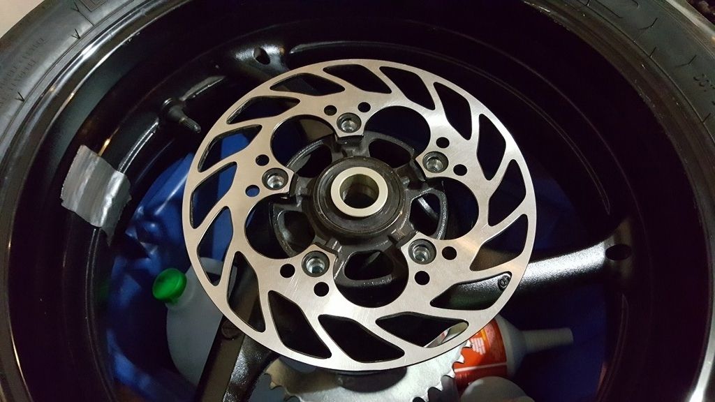

Thought this might help a little. Dropped just under 1/2 pound in rotating mass off the rear rotor. Just for Sh!ts and Giggles.
