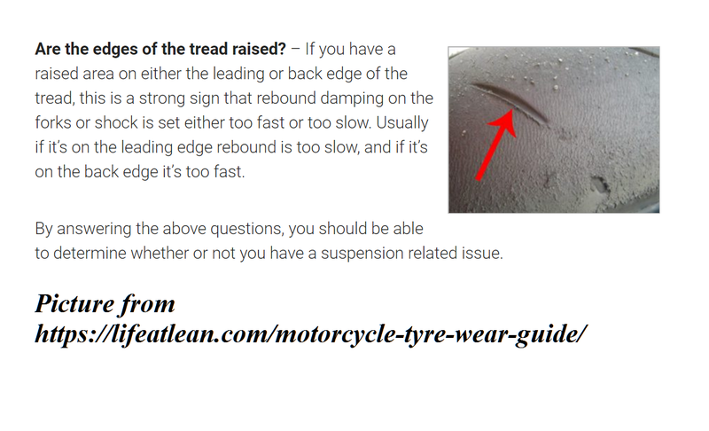

1st Pireli recommendations http://www.trackaddix.com/PirelliRaceTirePressures.pdf
Yours appears to be leading edge indicating to slow a rebound, you'd might try backing off a click or two.
I took three clicks out of the rebound over the last couple track days and haven't seen any change in the leading edge, which is why I am beginning to wonder about the geometry.
