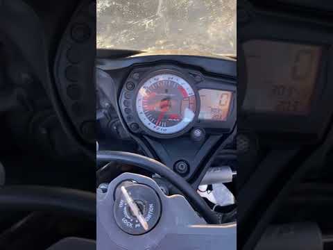

Hello guys,
I have a 2008 gsxr 600 and I have an issue with the idle. It stays only at 1000 rpm and it dies if I don’t speed up when i leave and also is sputtering . After 4k rpm the bike runs good, no problem. I don’t know if there is a conection with that but when the engine is hot and I refuel the bike will start like normal (all the time) . Sometimes is working good when is hot, but only sometimes.until now I changed the spark plugs, fuel pump with the filter, adjust the TPS sensor, I bought a PC with the hope that it might work, changed the ISC valve (if I loosen the 2 screws that hold the isc valve and pull the valve a little bit out while is running the idle is increasing) so I think is something with the air-fuel ratio mixture . I also checked the primary injectors. They have a good spray pattern. I will try to attach a video so you can see.
I checked the vacuum hoses also and tried to start with the IAP sensor unplugged with no luck.
Any thoughts?? Please help
Thank you
Attached a video with the problem

Welcome to the forum.
Check that all cylinders are firing when at idle by checking each header with a spray of water.
I was trying to hear in your video of it sounded like all cylinders were firing but you kept blipping it so that didn't work.
The other thing is that the idle speed needs to be set with the Suzuki diagnostic tool or equivalent. I'm sure changing the ICS did not help this.

Just listening to the video again, it does sound to me that one cylinder is not firing correctly.
I was hoping you could pin it down with the header check.
Just watched and listened again and I believe the low rpm (1k) is due to a cylinder going off line at idle.
You an also use a an infrared heat detector gun and I've also used WD40. WD40 will flash off a running header but usually just smoke on a cooler one.
