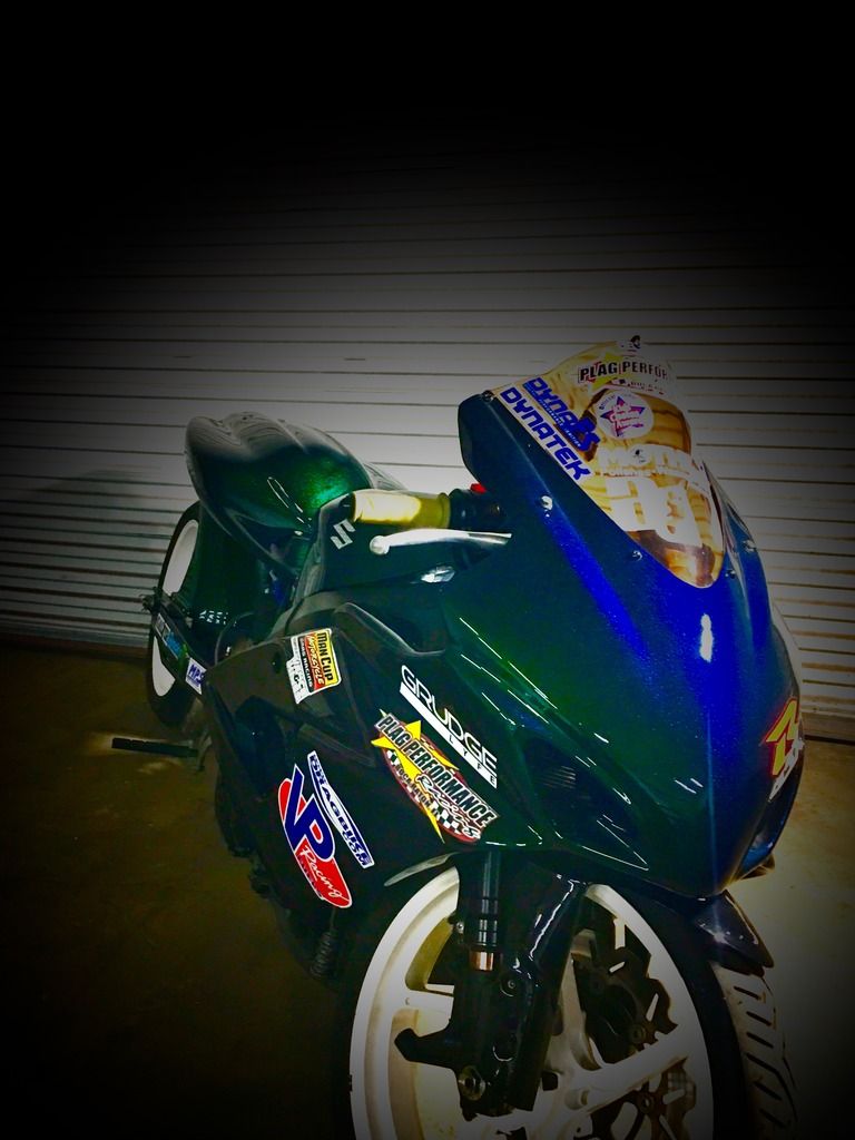

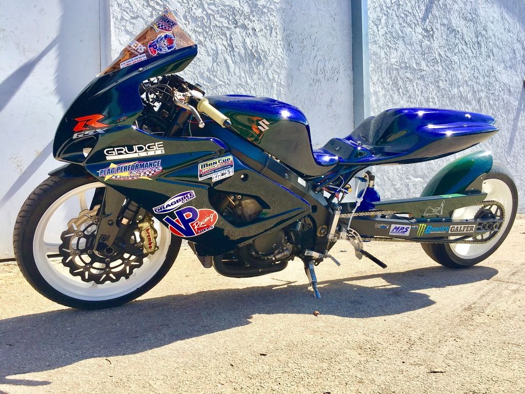

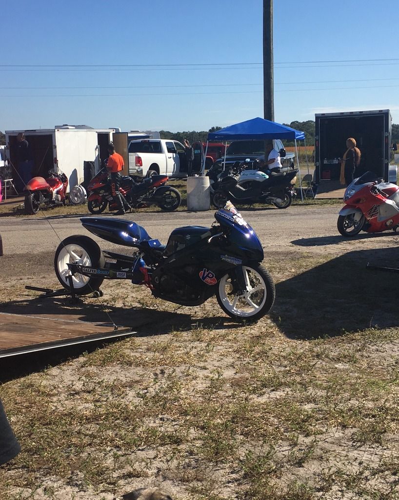

Might as well put up one of my babies
Full carbon fiber bodywork
3/4 front fairing, grudge step tank, and extended tail. All custom painted chameleon paint with heavy flake.
Dme front battery rack
Hardcore swing arm with built in air tank
Oz peiga wheels powdercoated white with micro flake
Custom rearsets
Mps airshifter, pro shift button/air gauge
Fully built motor can't detail because of grudge bike, but is. Nitrous motor
Penske triple adjustable shock
Dme flat link
Dme custom lightweight subframe
Walbro 255 external fuel pump, aeromotive fuel pressure regulator
Full nitrous express setup
Mps nitrous spray bar
Vortex clipons
Mm carbon fiber chain guard and tire hugger
Mps tether kill
Crg adj levers
Mps killbox
Daytona sensor nc2
Front forks cut 4 inches
Front brake brembo master cylinder
Brembo front caliper
Brembo wave rotor
Billet triple tree
Etc
