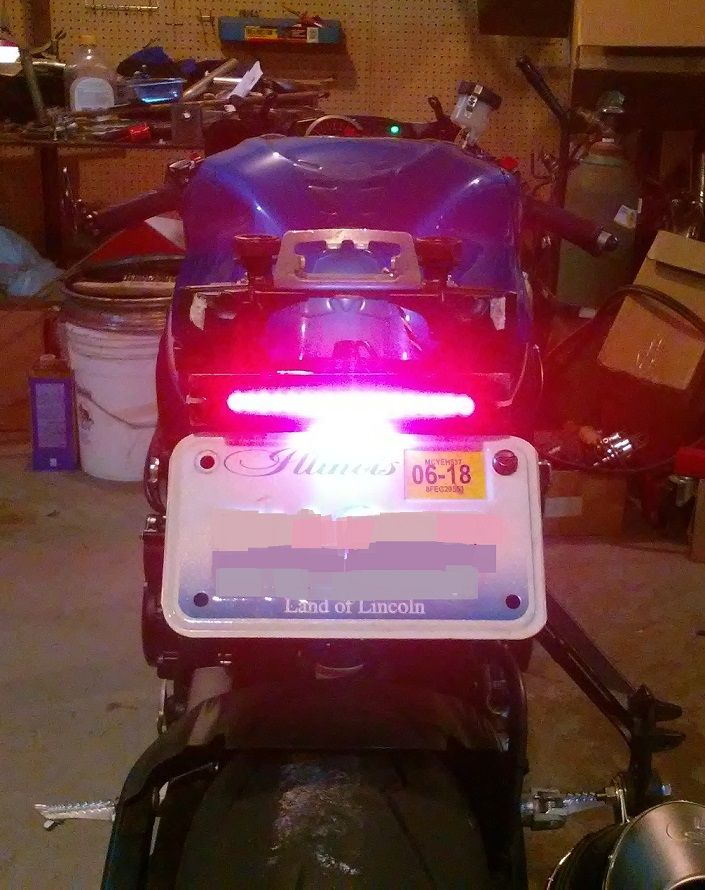

I'm planning how to make the bike barely "street legal" while utilizing the race plastics. I was thinking a mini projector lights and a custom mount. I fabbed up a bracket to mount a tail/brake light sandwiched between the fender eliminator and the undersurface of the frame. I've been fortunate enough to have learned how to tig weld and brackets like this are an easy thing.

I'm planning how to make the bike "street legal" while utilizing the race plastics. I was thinking a mini projector lights and a custom mount. I fabbed up a bracket to mount a tail/brake light sandwiched between the fender eliminator and the undersurface of the frame. I've been fortunate enough to have learned how to tig weld and brackets like this are an easy thing.

Taillight
