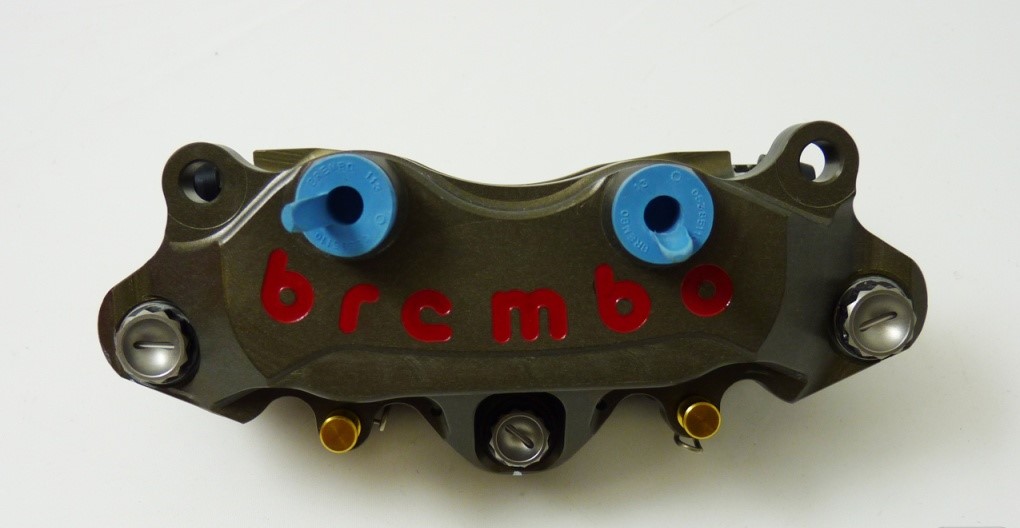

If anyone is interested... I may have worked out a way to convert the rear brake to underslung for the 2011+ 600/750.
The only place I could find that makes a direct replacement adapter is from England and it's almost $900 for the entire quickchange rear. Which is about the going rate comparing to Fast by franks.
Again this is 99% cosmetic, IMO. Rear tires changes would be easier... But ultimately, a single piston sliding 30mm is gonna perform better than a lot of these micro rear calipers even if they have brembo in red and are "carved from billet."
Im still collecting parts and taking measurements but here's a gsxr1000 and a stock gsxr600/750 stock rear caliper bracket side by side.
Bicycle part Tool Font Wood Bicycle drivetrain part
I asked a couple bike builders and racers... most of them told me to just stick with stock. About half say they don't even use the rear brake... Cross another mod off the list...
See less See more
Reactions: 1
Some reason this is satisfying to me. spooned on a lightly scrubbed SC1 rear and test fit the rear wheel with some new parts.
Sry cant embed video.
I am finishing up the underslung caliper conversion for the 11+ 650/750 because well I started it. You can do it for under $300 with a cast brembo. Here's how... the gsxr1000 09-16 caliper bracket is the same as the 11+ 600.750 bracket EXCEPT the axle center is 25mm instead of 28mm. A 09-16 gixxer thou brembo bracket kit and a metal sleeve to sleeve down the axle hole from 28 to 25mm and youre set.
Unfortunately, I was informed brembo stopped making that specific gixxer thou bracket and the kit is unavailable from the factory... you might be able to find leftover stock somewhere. There are also copycats on the internets however some may require a little lateral shimming to get perfect. Superbike unlimited offers one availabe to order in 2-4weeks. I have a sneaky suspicion it is the Taiwanese sourced brackets however I trust Superbike umilimited's products as they are involved with and put their parts on actual race bikes.
I ended up with a Taiwanese bracket off ebay (that required a 1.5mm shim from Mcmaster carr), sleeve from amazon and brembo caliper. The cast brembos are only about $180 and @ 34mm are probably well sized for the 14mm stock rear master.
You can find billet brembo rears ranging in price from $400-$1500 dollars but that's more for show, not for go realistically. OPPracing has probably the best website for listings for you to window shop. A totally cool caliper is one with TWO inlets FOUR pistons in TWO separate circuits. So you can hook up your thumb brake and rear brake to the same caliper but have completely separate systems? LOL!
(I found one seller on ebay selling 64mm brackets for the 1000... vs the regular 84mm brembo kit)
Best prices right now are overseas unfortunately... even with shipping. Caprimoto and a place I've never heard of before genial moto have some great prices. Make sure you know your credit card foreign currency transaction fee and figure this into the purchase price as well. The higher the price the better the saving buying from italy at the moment.
The video above is with the bracket and shim installed. Awaiting the caliper and i guess I'll need a longer brake line.

Stock rear caliper is light as f!!!! 375g without pads!
That's lighter than all the brembo calipers billet or cast unless you go crazy expensive with just miniature pistons.
