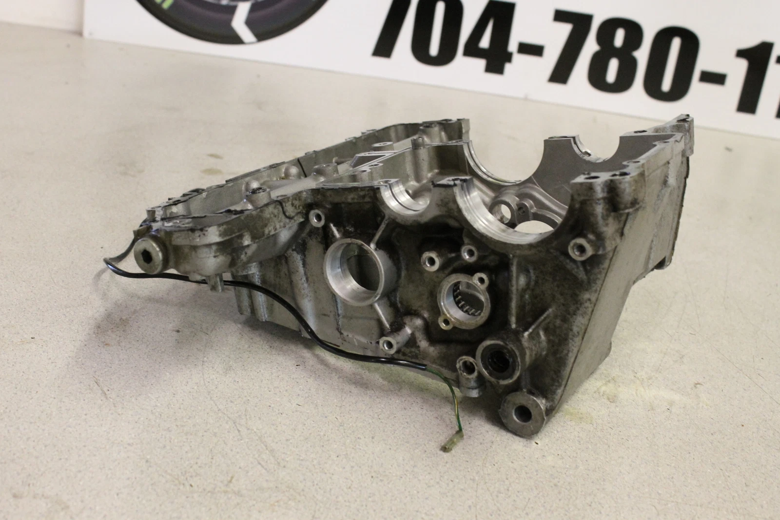

this current leak, I am positive on where it’s coming from. I’ve cleaned all surrounding areas and waited to see where it was leaking, to be sure it wasn’t running down to that spot from somewhere else. It’s most def leaking from that Phillips head bolt/screw at bottom of water pump. Where the pump splits. I added a photo of the split location except my leak is at bottom, I couldn’t get a decent pic from the bottom side.

#14 ·
if you want to remove the waterpump without draining the oil, lean the bike to the right.
in my case, a paddock stand keeping the bike upright worked for me.
To make an educated guess, look at the oil level in the sight glass, and estimate the oil level if it is slightly below the waterpump housing
I am thinking if it's likely that the oil came from elsewhere, either the front sprockets oil seal, chain lube, or maybe the stator cover which is located in front of the waterpump
looks oily here, and here
this housing only has coolant
#20 ·
I just realized this yesterday after taking a closer look at the photo you drew a green line on, that’s exactly where it’s coming from. The source I have not dialed in yet, but wherever it is, is a very very small amount. Or at least it’s a very small amount making its way to the location described. Thankyou
