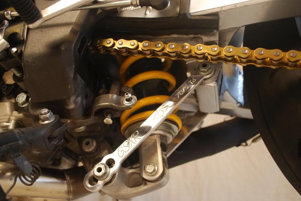

PO used a set of lowering links as seen in the photo
I assume the hole nearest the "G" would be the factory height, and I assume the shock linkage is factory. The spring has not been cut, but the PO backed-off the pre-load completely, which makes the sag quite pronounced when I sit on the bike.
I plan to raise the bike back to factory (front and rear) later this week when my new side stand arrives.

BTW. You can find stock links for about $25 on Ebay or probably cheaper at a salvage yard. They don't normally get damaged in a crash so there are plenty of them.
You mentioned you were waiting on "side stands". I'm guessing you meant a rear stand. This will not help to change the link as you need to get the weight off the rear swing arm. You can put two jacks under the rear sets or a pipe though the swing arm pivot to lift the bike.

Yep. New kick stand (aka sidestand). Got a minty kickstand w/springs and bolt for less than $35.00--taken off a 2004 right in the dealership to make the bike a track racer right from the start. Part was brand-effing-new!
Used a steel rod through the swingarm pivot and jackstands and a floorjack with a block of wood under the oil sump. All is back to factory settings along with pre-load and damping. Rear of bike is now 1 3/4" taller than PO had it. Haven't recorded front yet--still have the cowling and fairings off for the steering damper work.
